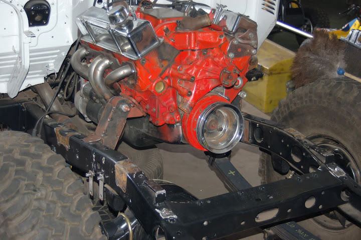

Most guys here knows the build from LCCSA, so I'll post from what happened the past 3 months to this truck. For the guys that don't know the truck, I've chopped and shortened the bin and chassis and this truck will run with a Chev V8 mated to a 5 speed gearbox( think it comes from a pre 90 75 series Pick up)..
I recently found 2 80 Series GXL diffs for a good price, and while I was already planning a coil suspension conv for this truck I bought both diffs, I was also very lucky as the rear had also OEM disc brakes.. I completely changed the trucks leaf sprung suspension to a complete front and rear coil suspension. It looks real neat sitting on coils! 80 Series power steering box has also been fitted.

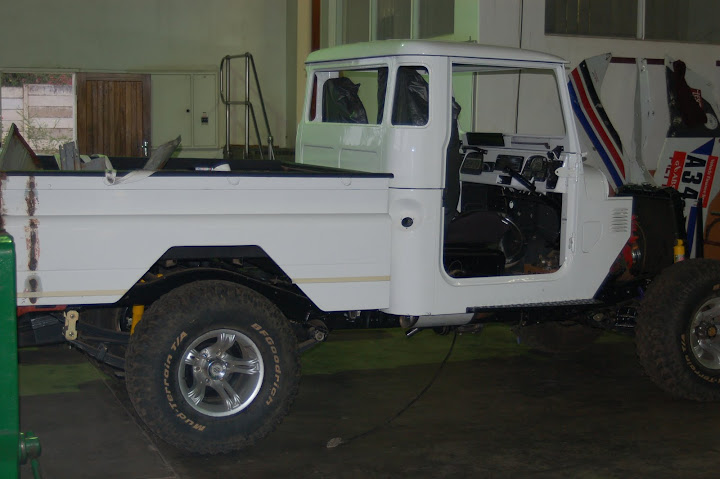

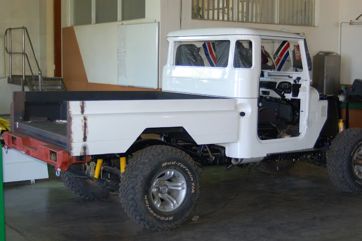

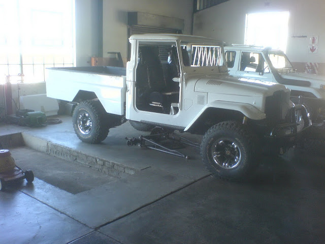

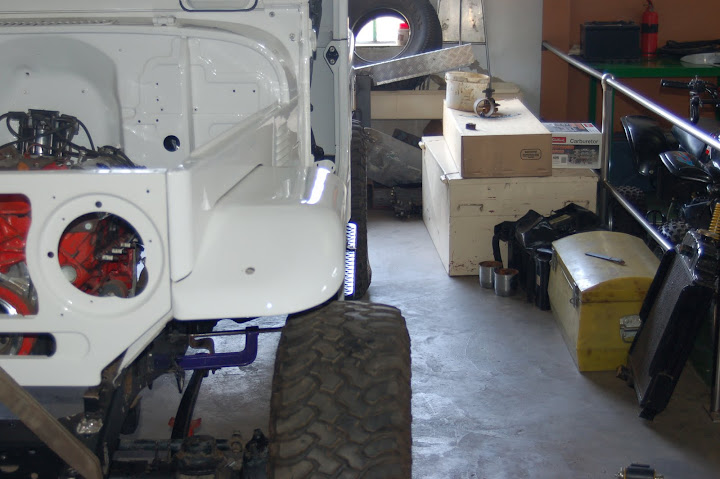

The way it looked when I first assembled it 4 years ago; fitted with GM Diesel V8, OME Suspension, and 33x12.5-15 muds.
Then I got an itchy bum and shortened it by 350mm..
Still not happy with the way the bin looked I decided to make it more shallow, basically the same way as what the newer 79 series bins looked like. Note the markings where I wanted to cut it. Before and after pics..

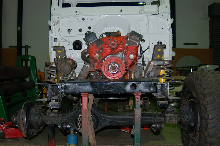

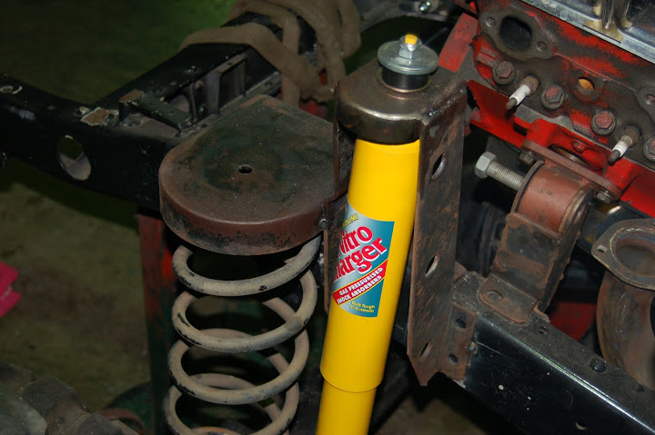

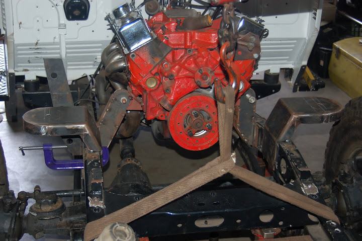

In order to build all the shock and coil towers, I had to remove the factory OEM shock towers, and while I was busy doing so, I removed the steering tower aswell.
Moment of truth, time to fit the front 80 Series diff.
Note how much wider the new 80 Series diffs will be to the standard 45's diffs.
Building the shock and coil towers.
Finished.
It's new suspension.

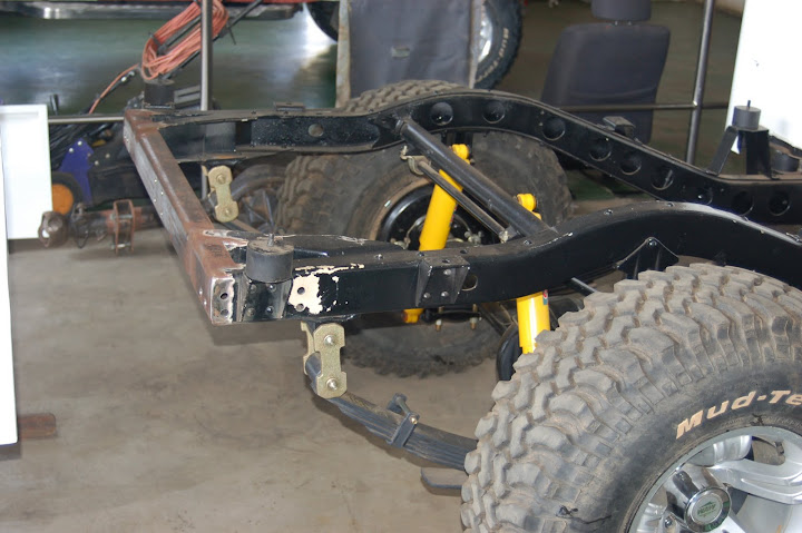

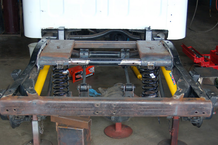

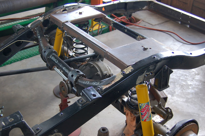

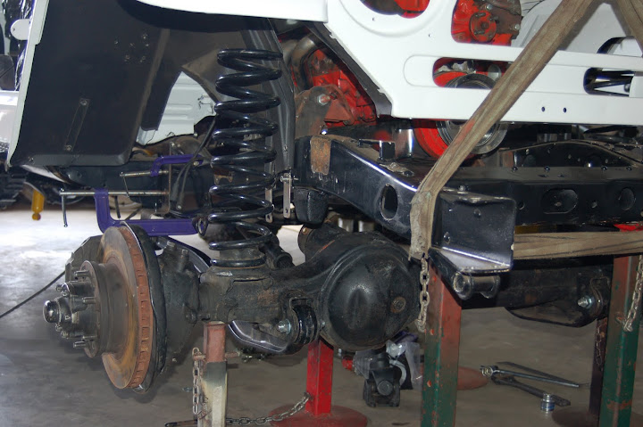

The rear suspension.
I had to move the coil carriers each 100mm more to the inside due to the fact that in standard position the 45's chassis rails were right above the carriers and I wouldn't have been able to fit coils in there. Due to that I had to also move the top stabiliser mounting points.
Also had to make some cross-members to make everything fit. Still have to make some small reinforcing pipes to connect the 2 new cross-members.
While building the rear suspension, I figured out that the solid mounting point where the rear leaf springs mounted would make an excellent new mounting point for the lower stabilisers if I cut them loose from their position and position them correct for the stabilisers,I will just have to machine some spacers to space them up correctly.. As they are cast, I wouldn't like to weld on them, so I made a backing plate that I'll weld onto the chassis and that would reinforce the chassis. I'll bolt these mounts to the chassis.

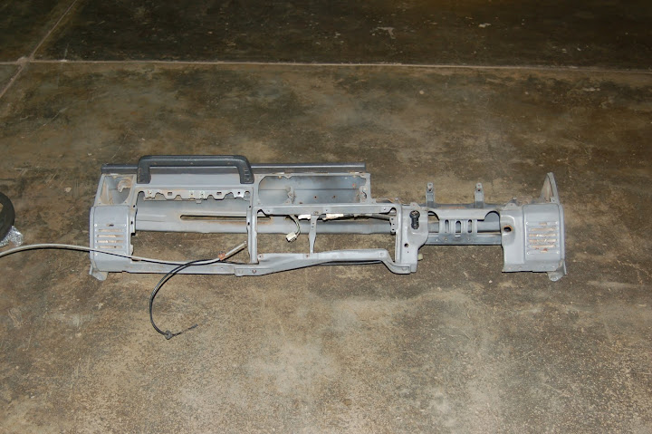

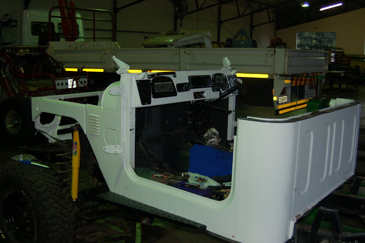

Perhaps I've now completely lost it, but I once saw a pic on the net of a 45 fitted with a 75 Series dash panel and I really like that. So I thought that while I was busy doing some serious mods to this truck, I might aswell give some serious TLC to the interior and fit a 75's dash. So I got a complete dash together with the tilt colum. Will start with this mod somewhere this week. Took the roof of this afternoon, so I can now start cutting and fitting.
This;
must now go into there..
