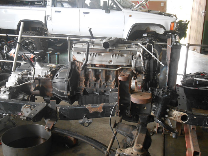

Did a tiny little bit of work recently to this truck.
Mated the 1HZ to the h55f and fitted it. Somehow my measurements were out by 60mm's so I had to cut loose the gearbox and motor mounts and move everything forward by 60 mm's :-[.
Here's the 1HZ going in.

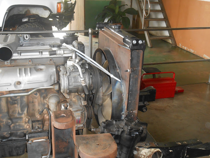

1HZ with radiator and cowl. (Note the SFA Coil sprung Hilux I am busy with)

« #123 : February 21, 2013, 12:13:29 PM »
I like that viscous fan cowling even more than the closed filler ! Looks like the fan blades enter just enough ! Great work ... as usual !  8)
