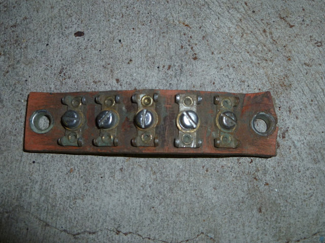

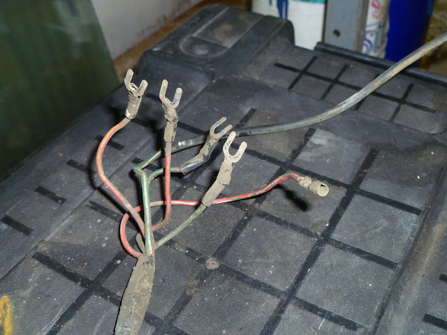

« #28 : April 10, 2011, 10:12:23 PM »
Original wiring Junction box mounted on inner fender for Headlights ,Bib lights ,Indicators .
Simplicity at its Best . :)
