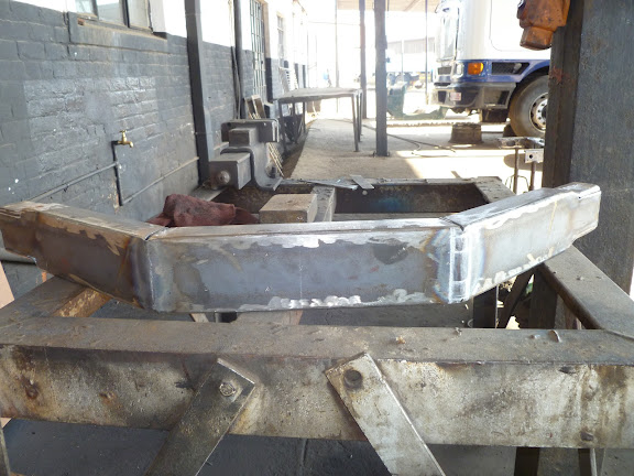

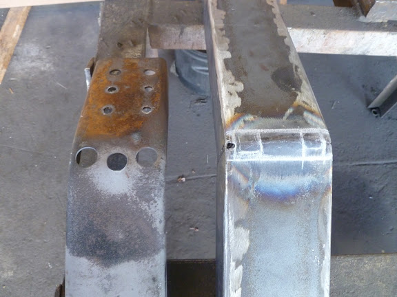

« #26 : July 27, 2012, 09:24:54 PM »
 Standard configuration .My Rear Bumper was bent outwards,from flimsy triangulation member .
 Fabricating a new member out of 100x 50 channel 6mm thick.Original members only 3mm thick
These holes just weaken this .
 looked on a 45 series ,they use the spare wheel mount as an added support. member .we dont have that luxury of space.
« #27 : July 27, 2012, 09:40:00 PM »
Looks grand Rob,  :drinks: on working out the Picasa thing  :D

 Thanks Jonathan .Just did it on my Old Laptop . :-[
 Not sure how much these chassis need to flex and if that stronger rear member going to inhibit  it flexing and cause other issues ,but cant believe that it flexes too much at the rear .
 Time will tell . :)
