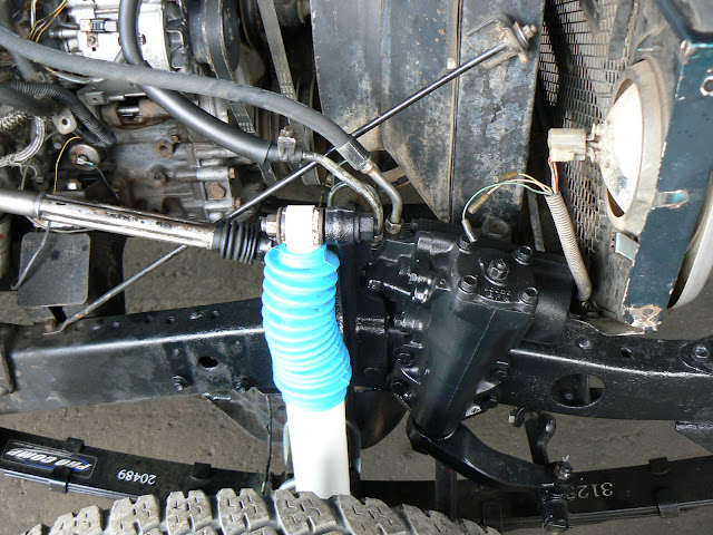

Hi Rob
I Need youre expertice
Did you have any hick ups when you did this powersteering conversion?
I allso laid my hands upon a 80series ps/box with pump etc. I now just need to source the steering links/rods
Did you box the chassis where the ps/box mounts?
Regards
Rudi
« : August 10, 2012, 09:12:21 PM Jonathan Tee »
« #35 : August 10, 2012, 09:16:20 PM »
Rudi see here for some more info http://www.gotbezel.com/index.php?topic=151.0
I know Grahame used tubular spacers on the bolts that run through the chassis.
Rudi Nel
Guest
« #36 : August 14, 2012, 06:02:49 PM »
Thanks JT
Some guys put two plates both sides of the chassis with the crushtubes inside, but if you put the second plate on the outside it radically inteferes with your clearances to the stock shock tower.  how do I post pics here?
« #37 : August 14, 2012, 06:26:16 PM »
I think I will just use a plate on the inside with crush tubes, and use the chassis rail on the outside. If you look at the design of the box mount, it is shaped to distribute the load over a larger area, a plate on the outside would negate this.
Rudi see http://www.gotbezel.com/index.php?topic=37.0
« : August 14, 2012, 06:33:35 PM Jonathan Tee »
Rob Wright
: 313
« #38 : August 29, 2012, 01:25:38 PM »
 Rudi .
 Sorry for late reply only saw yr post yesterday  :-[. I did use 80 series box and everything
 else was for early 75series . I also had to change both steering arms the ones that bolt onto Birfields as the 75 series Tie rod ends are bigger .On the 75 series trackrod where it mounts to the steering box i had to machine it down smaller to suit the box .The rest was all pretty straight forward ,Just look on my above posts for the steering column mod .The rest have gone 60 series route but it was easier for me to source 75 series bits  and will be easier down
the line to find bits .and also bigger so should be stronger .I didnt mount a plate or make up spacers for mine just made up 2 plates that slid into chassis behind main frame ,Should be plenty strong enuf .The box mounts very close to front crossmember which will help to strengthen it .If u need any assistance just shout (will reply sooner )  :)

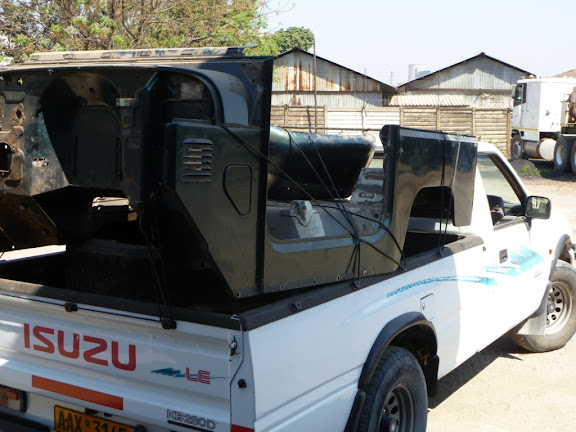

« #42 : October 13, 2012, 03:41:38 PM »
 Tub all stripped ready to go off to SandBlasting and see what quality work the aussies
 did when it was resprayed.
Rob Wright
: 313
« #43 : October 13, 2012, 03:48:14 PM »
 Tub in a sad state after Sandblasting .Half the weight now that all the Filler off .But not
 a pretty sight ,Lots of issues once its make up off . :'(
